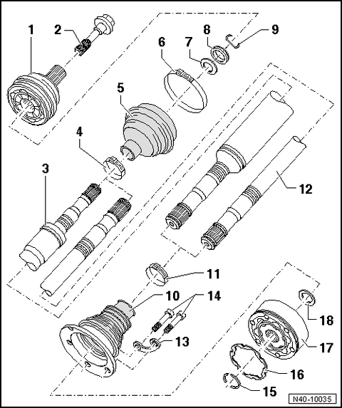

[td]Assembly overview: drive shaft with VL100 constant velocity joint
Outer constant velocity joint
[td width="30pt"]
1 -​
[/td]​
q Renew only as complete unit
q Removing .
q Installing: drive onto shaft to stop using a plastic mallet
q Checking
Bolt
[td width="30pt"]
2 -​
[/td]​
q Various versions
q Allocation

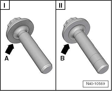

achtung.jpg WARNING
t There are two versions of the twelve-point head bolt, with and without ribbing. Distinguishing feature .
t When installing a twelve-point head bolt, always note which version is being installed.
t The respective specified torque must also be used.
t The specified torque for twelve-point head bolts »with« ribbing is 70 Nm + 90° when loosening and tightening .
t The specified torque for twelve-point head bolts »without« ribbing is 200 Nm + 180° when loosening and tightening .
q Always renew after removing.
Right drive shaft
[td width="30pt"]
3 -​
[/td]​
Clamp
[td width="30pt"]
4 -​
[/td]​
q Tightening
Boot
[td width="30pt"]
5 -​
[/td]​
q Check for splits and chafing
q Material: Hytrel (polyester elastomer)
Clamp
[td width="30pt"]
6 -​
[/td]​
q Tightening
Dished spring
[td width="30pt"]
7 -​
[/td]​
q Installation position
Thrust washer
[td width="30pt"]
8 -​
[/td]​
Retaining ring
[td width="30pt"]
9 -​
[/td]​
q Insert in groove in shaft
Boot for constant velocity joint
[td width="30pt"]
10 -​
[/td]​
q Without breather hole
q Drive off constant velocity joint with a drift
q Coat sealing surface of constant velocity joint with -D 454 300 A2- before installing.
Clamp
[td width="30pt"]
11 -​
[/td]​
q Tightening
Left drive shaft
[td width="30pt"]
12 -​
[/td]​
Locking plate
[td width="30pt"]
13 -​
[/td]​
Multi-point socket head bolt
[td width="30pt"]
14 -​
[/td]​
q Initially tighten diagonally to 10 Nm and then tighten diagonally to specified torque
M8 bolt: 40 Nm
M10 bolt: 70 Nm
q Always renew bolts after removing
Retaining ring
[td width="30pt"]
15 -​
[/td]​
q Remove and install with circlip pliers -VW 161 A-
Seal
[td width="30pt"]
16 -​
[/td]​
q Adhesive surface on constant velocity joint must be free of oil and grease!
Inner constant velocity joint
[td width="30pt"]
17 -​
[/td]​
q Pressing off
q Pressing on
q Checking
Dished spring
[td width="30pt"]
18 -​
[/td]​
Distinguishing features between twelve-point head bolt with ribbing and twelve-point head bolt without ribbing.
The twelve-point head bolts can be distinguished by the contact surfaces -arrow A- and -arrow B-.
[td width="30pt"]
I -​
N40-10569
Twelve-point head bolt with ribbing -arrow A-
Twelve-point head bolt without ribbing -arrow B-
